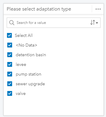

I am trying to create some plots from a text column which has categorical values. Now when I add a filter for this column, the filter does pickup every value as shown below:

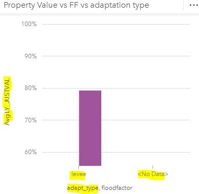

However, the plot is only picking up `levee` and `No Data` which is an odd behavior.

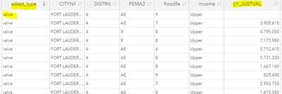

Every categorical value in the adapt_type column has a value in the `LY_JUST` column. Even the snapshot of the datatable shows that for example adaptation type `valve` has `LY_JUSTVAL`.

@Ed_,
Do you have two values being displayed on the x value? It appears you're plotting {adapt_type} and {floodfactor} which I think would affect the results.
