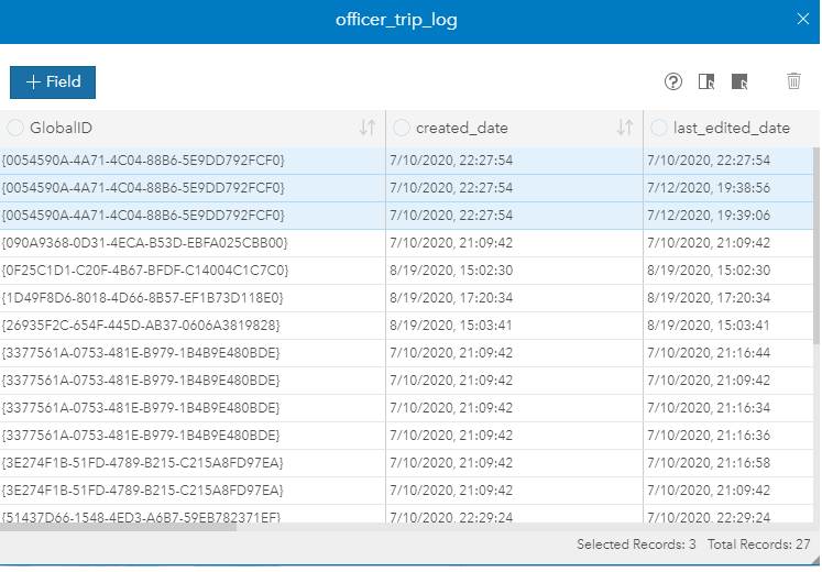

Here is what I am seeing in Insights:
When I look at the data in the hosted layer I see 14 records. When I look at the data table in Insights, I see 27 records. In Insights, many of these records have the same Global ID, and selecting one row selects all the rows with the same Global ID. Basically - these duplicate rows behave as one.
As I look through the attributes, I can see exactly which rows correspond to each edit that has been made to the data and the incrementing Editor Tracking date fields. Only the row with the most recent Edit date matches the row that is visible when I look at the data through any other application.

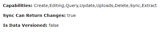

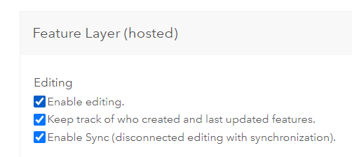

I see in the Insights doc that versioned databases are not supported by Insights. The REST endpoint of the affected layers shows that versioning is disabled and no replicas exist.
The layer does have related tables, and sync is enabled. The data has been edited through a combination of Survey123, ArcGIS Pro, Python API, and Workforce.

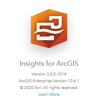

Hi Jon,
Here is the About info for Insights/ArcGIS Enterprise.
