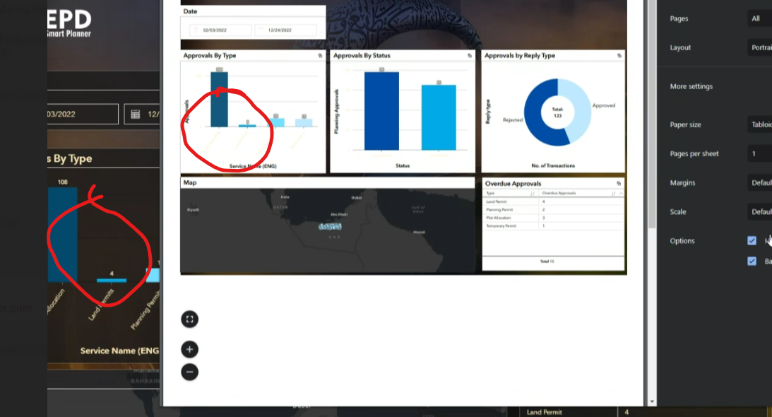

I'm currently encountering an issue related to the colors in my published reports. Specifically, when I attempt to print a report using the report viewer, the colors are not coming out as expected. (when users try to print reports using their browser's print functionality,) the colors in the printed version are also different from what is displayed on the screen.

Sorry May be i am not mentioned it clearly, My agenda is the color between card background in the report and printed preview in the browser is different, in my snapshot card background color is black and chrome browser report color is white and also background banner is black color also not came.

I have Designed the Report using the Report designer and published. After published who will  view the report, the person want to print the report by browser the colors are varying whatever we seen in the browser and print.

I see what you mean. Currently, the report designer functionality is only available for the editors of the workbook. You can download the report here and share it separately.
Unfortunately, the report designer functionality is not at a stage where the viewer of the report can download the report. We have noted this enhancement and is under consideration.
Printing through browsers has limitations and not all the graphics come through which is why we built a report designer with a module that can render the app's graphics properly.
If you still wish to use this the way you are doing now. I would recommend keeping the colours simple, card background white and paying extra attention to margins.

I think by default the report prints on a white background, as printing with that much black ink is almost always undesirable – from a cost and environmental standard. However, there is a solution I just thought of.
1) Set page options so that all cards have transparent background.
2) Set page options so that all cards have white (or lightly colored fonts)
3) Create a new empty text card in Page View and enter a single space.
4) Give the blank Text Card a black background fill.
5) In Report Designer go to PRINT
6) Add the blank, black Text Card
7) Resize the black card to cover the entire print page
😎 Send the black text card to the back
9) Hit print
I hope this helps!
