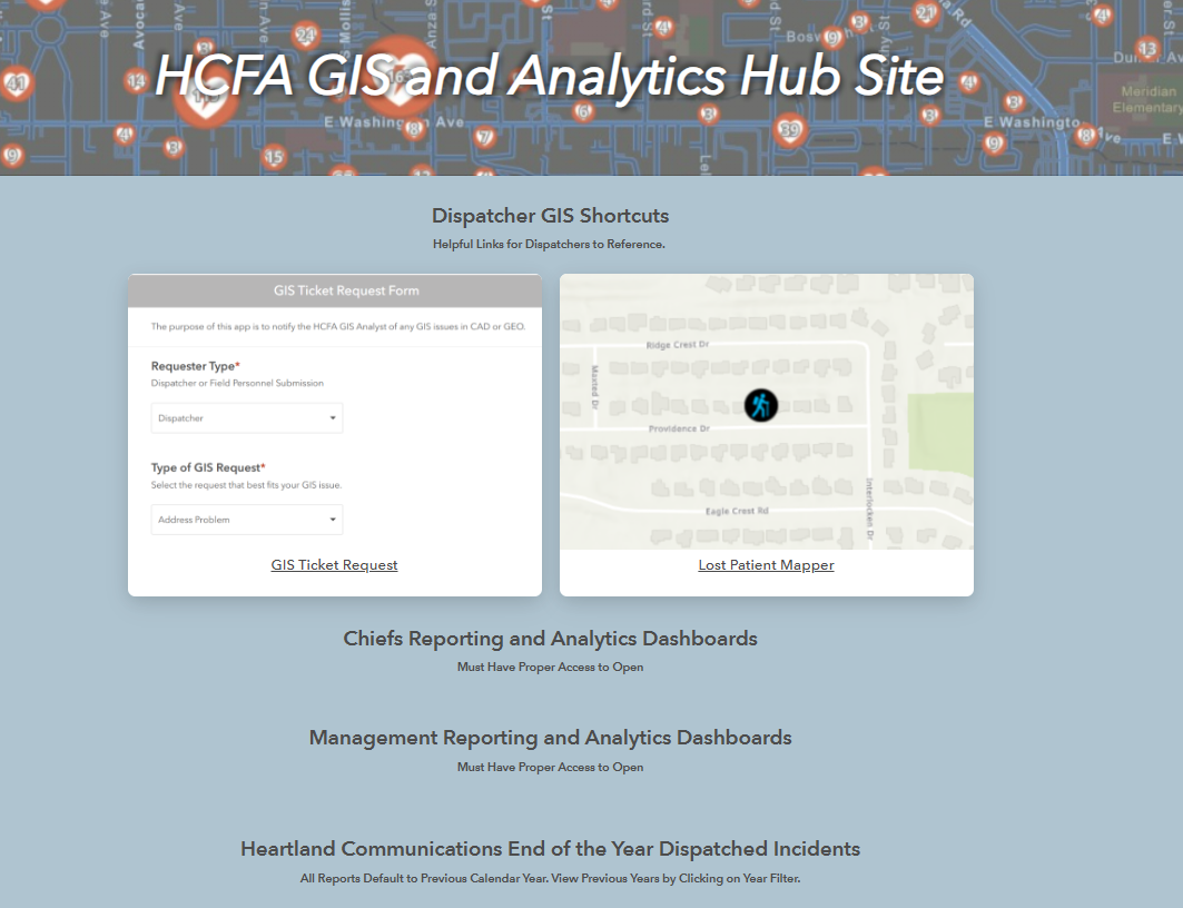

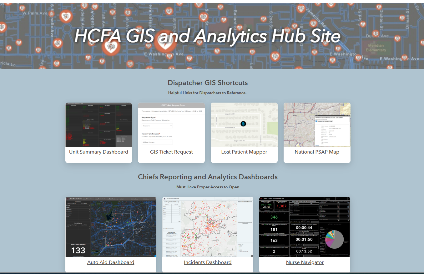

Hello all! I am pretty new to hub. I am trying to put together a hub page that has things for the public and different internal groups. Below in the first image is what it looks like under my login.  Notice all the tiles. Some of the applications in these tiles are private, but is there a way for the tiles to still show on the public side even if the application itself is not public? Then if someone hits the tile it would ask for log in?
When I publish the site and make it Public, all the tiles of the dashboards and apps that aren't public don't show anymore.  I was hoping they would still show even though the application itself is private.  Or am I doing to have to create different hub pages for different internal groups?

Your best workaround may be to add Text cards instead which are not dependent upon permissions (unless the visibility of a Row is set to only appear for particular groups). There are some useful guides for formatting text cards (e.g. https://community.esri.com/t5/arcgis-hub-blog/make-your-site-dynamite-with-calcite-design/ba-p/13863...). Then user's could still click the links to the applications but they might be required to login where appropriate?

Thank you, I will give this a try.
