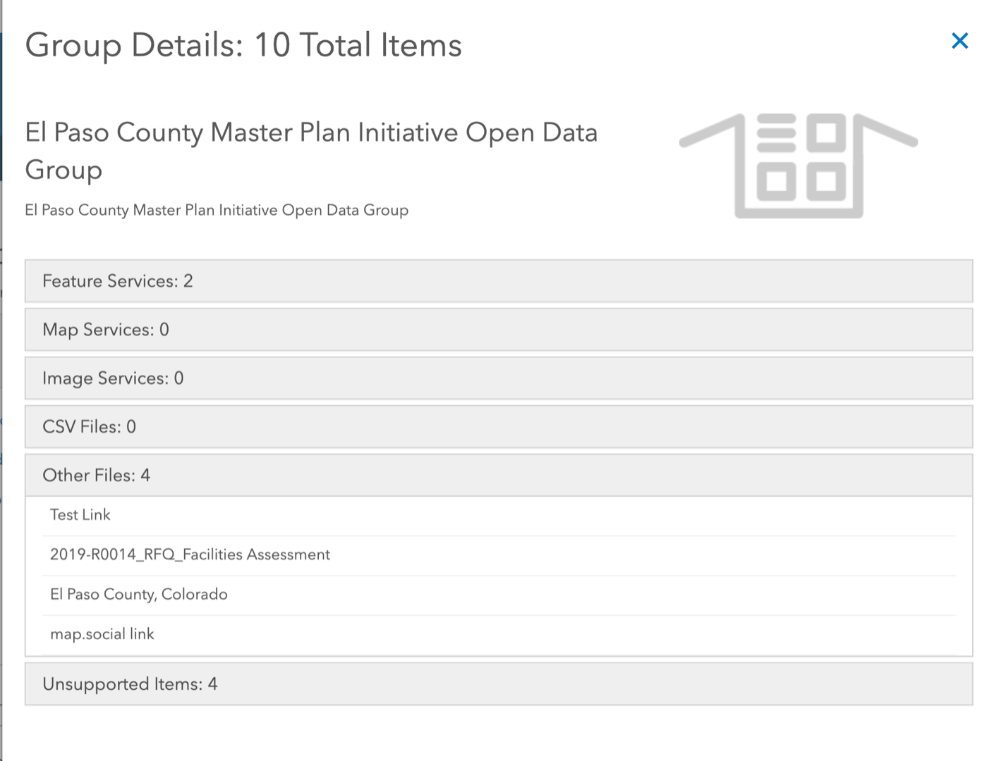

Links to documents and websites I have created do not show up in the ArcGIS Hub "Gallery".
The steps I have taken are as follows:

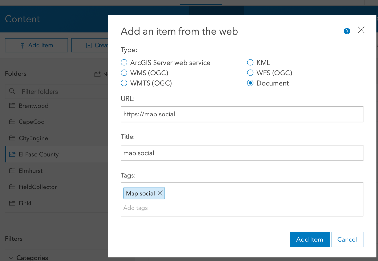

In ArcGIS Online I Add Item--> From The Web --> Document
I then share it with the Public and my Open Data Group linked to my Hub Initiative.
When I go to my Groups Manager the items show up as expected.

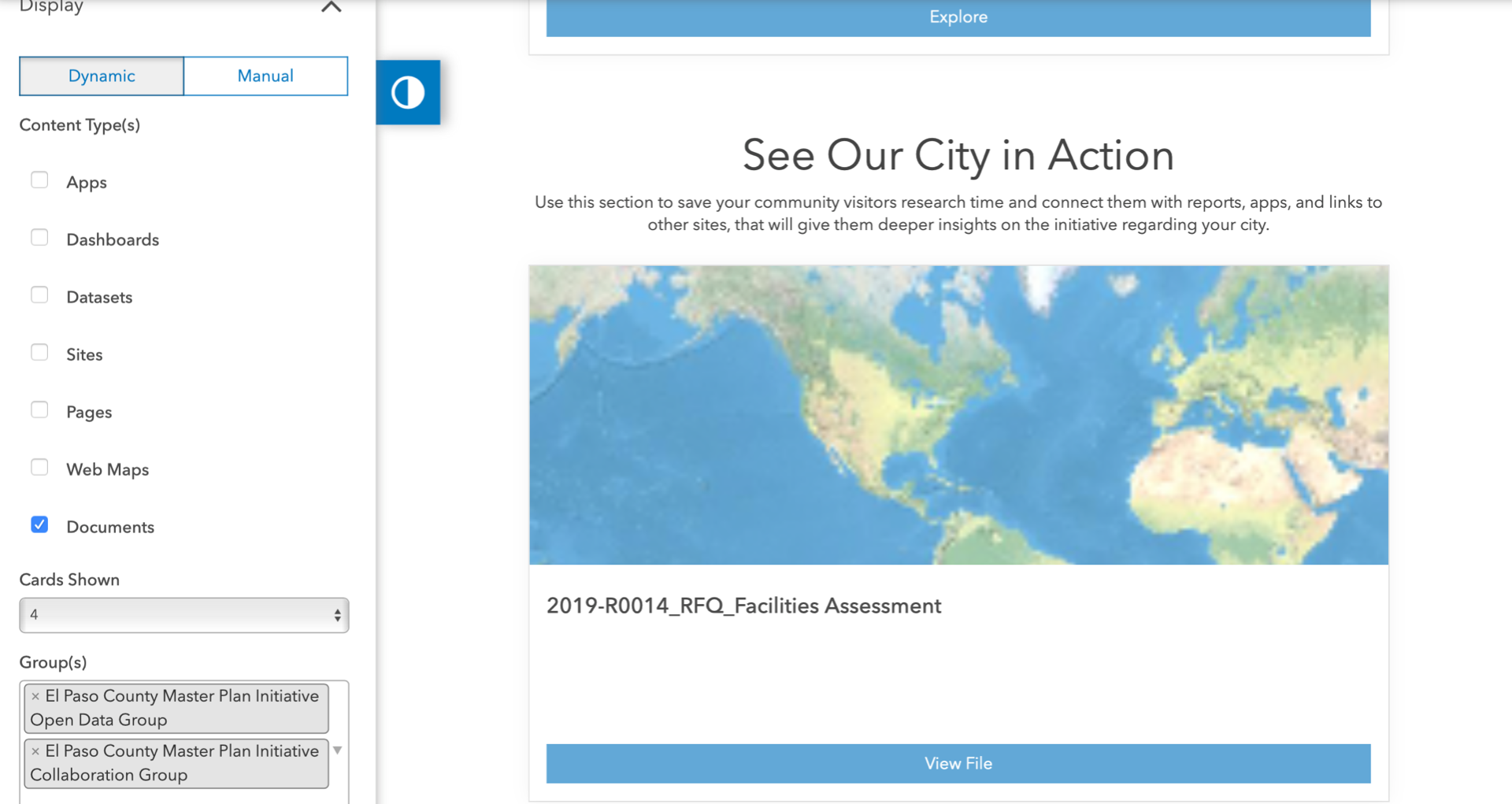

But when I am in the Site Editor editing the Dynamic Gallery the items do not show up. The only file that is showing up is a PDF I uploaded to ArcGIS online. Links to webpages and linked pdfs are not showing up.

Hi Devin -- Document Links are not yet supported by the Gallery Card, current document types supported include...
  • PDF
  • Microsoft Excel
  • Microsoft Word
  • Microsoft Powerpoint
  • iWork Keynote
  • iWork Pages
  • iWork Numbers
  • Visio Document
Expanding that suite of types is on our near-term backlog, stay tuned to our Hub Changelog.

Devin Lavigne‌ support for document links in the Gallery Card will be available next week.
