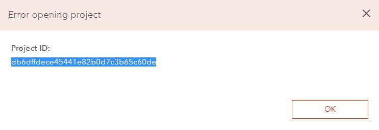

My classmates and I are attempting to use GeoPlanner for a landscape planning and design class, and we are having a pervasive problem with our saved GeoPlanner project files becoming un-openable either days or sometimes only hours after they were created or last saved.  When attempting to re-open a project from our respective accounts' "existing projects" menu, the following error is all we receive:
... with error db6dffdece45441e82b0d7c3b65c60de identified but no other explanation.
Please help... this problem in preventing ALL incremental progress on our projects.

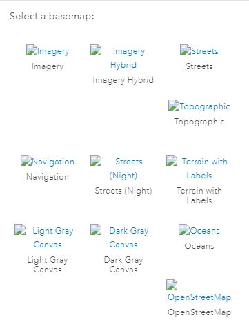

  >The second time encountering this error was with a project I'd started myself based on the Esri 'GeoPlanner Template for Land Use Planning'.  I'd worked on the project intermittently for two days, adding a set of layers in a file geodatabase I'd uploaded to ArcGIS online as a feature service, and was experimenting with classifying some of them and changing visibility settings.  I hadn't yet loaded any data into an existing design layer in the template, or created any new ones.  I did invite my partner on the assignment into the project using the 'Invite User' button in the project's file menu.  I believe the last thing I did before saving and closing the project was try changing the basemap to 'dark gray canvas'.  As a point of interest, this is what the basemap selection pop-up looks like whenever I open it in GeoPlanner:
The dark gray basemap did load though, so I saved and closed the project intending to reopen it later and continue working.  However, two days later when I tried to reopen it I was presented with the 'Error - Unable to Open Project' warning.
