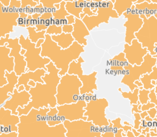

I am want to use the ArcGIS Maps for Power BI visual to display our orders based on Local Authority Districts / Unitary Authorities in United Kingdom.
What I have noticed though is that some Districts do not display properly.
The ones that do not display although we have sales from those areas (e.g. using postcodes you can see points in those areas) are the following:
Wyre Forest, North Northamptonshire, West Northamptonshire and Buckinghamshire
You can see what is missing in the following picture although we do have sales from those areas.
Is there any way to fix this in Power BI or does the fix have to be applied from esri?

@IPSN88 can you send me the feature service you're using to display the districts?
Depending on the service you've chosen, these might not be visible for a good reason (ie, with county data, certain counties no longer exist except for ceremonial purposes)

@IPSN88 - Hello there! My name is Anthony and I am a product engineer on the ArcGIS for Power BI visual. I was looking over this issue and I would like to help out if I can! 🙂
If possible, could you post your dataset here? I would like to compare this data using the previous version and our newest version to see where the issue is stemming from. It might be as @David_Brooks has mentioned; something might have changed on the backend around these districts/locations and it is causing them not to appear on the map.

@IPSN88 - Thank you for providing some data for me to look at. It helped out quite a bit!
I compared this data using our previous visual (1.0.0.110) and our new release (2021.1.91) and the results are the same for each of the administrative boundaries in the United Kingdom.
Below is a comparison between the two versions.
In ArcGIS for Power BI, we gather this data from our geoenrichment services and then place it on the map.
Was this working prior to the latest update? If so, we have temporarily rolled back the latest update and the previous version is available on Power BI Online and Desktop. If the results appear the same this version, then I would recommend reaching out to Esri Support to place an issue with the geoenrichment team/services as this issue doesn't seem to stem from our visual itself.

The issue is definitely with the source data which based on what you said comes from geoenrichment services.
As I said before, the missing spots on the map come from Wyre Forest, North Northamptonshire, West Northamptonshire and Buckinghamshire.
I am not sure about Wyre Forest, but the other ones were only recently created, in the last 6 to 18 months.
North Northamptonshire and West Northamptonshire  are new unitary authorities created and Northamptonshire was abolished.
Same for Buckinghamshire which I think includes Aylesbury Vale, Chiltern, South Bucks and  Wycombe districts which were abolished.

If it helps, it looks like the Wyre Forest district is being mapped on top of the Wyre district (similar names but different parts of England).
West Northamptonshire and North Northamptonshire appear to be plotted on top of one another.
Still don’t know where Buckinghamshire is hiding though.
