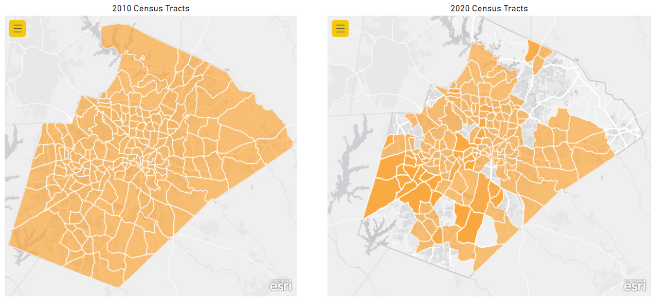

I have a current ArcGIS visual that is using census tract boundaries as the location type. The dataset that contains the census tracts is for ACS 2019 population estimates for a single county and uses 2010 census tract boundaries. I recently downloaded updated ACS population estimates which are for 2020 and the census tracts boundaries have changed. When I try to use the census tract as the location type for the 2020 data I am noticing that not all census tracts are mapped and some are incorrect.
The screenshot below shows the difference between using the 2010 census tracts as the location type vs the 2020 census tracts. Also attached csv files for each set of data.
Wondering if the visual may not support using 2020 census tracts and if there is a workaround or fix for this issue.

@DanielMcMartin - We just updated the census tract to be 2020 in June. Could you check if the issue still persists?

Hi @CHatchell - My name is Andrew and I am a dev on the Power Platform team. I loaded both CSV files. The PopEstimates2019.csv does not display all the boundaries but the PopEstimates2020.csv does. Could you confirm which file uses the 2010 census tracts and which one uses the 2020. Could you also share where the 2020 ACS population estimates are downloaded from?

Hi @AndrewLau - The 2020 census tract boundaries are now displayed correctly. I noticed this started working on Tue 6/28. Also saw this post from last Friday noting the 2010 tracts are no longer mapped accurately in the latest version. It appears an upgrade was made to start using the 2020 census tracts, is that correct?
AndrewLau
@CHatchell - That is awesome news! Yes, the upgrade was made in June 2022. Here are some links with more information on the update and census tract changes between 2010 and 2020.
