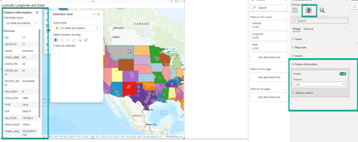

Hi @AdebMoustafa,
Thanks for your question! I hope you like the new version so far! In the June release, we tried to make the map clean and nice. To see the information from ArcGIS layers, you will need to go to Formatting pane and find Feature information, toggle that on, you will see a side panel on the map. When you click on the ArcGIS data, you will see the information on the side panel. You are able to collapse or expand the panel and change the position of the panel.
See more information here https://doc.arcgis.com/en/microsoft-365/latest/get-started/feature-information.htm
Please let me know if you have more questions or concerns. Thank you!

Hi @AdebMoustafa,
Based on the screenshots you attached, it seemed like you didn't sign in to ArcGIS on Power BI online. Could you please try to sign in and see if it works? Thanks!

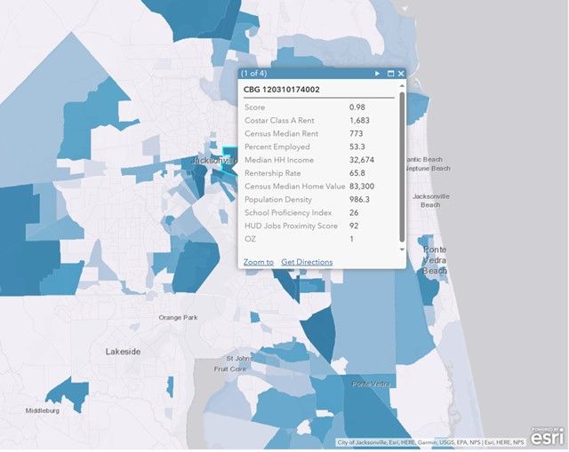

I wanted to join this conversation and note that I have having a similar issue. This is a screen shot from my ArcGIS layer with the pop up shown. Until two days ago the pop ups on Power BI ESRI map looked just like this. Then two days ago all of the pop ups stopped working. Your help is greatly appreciated.

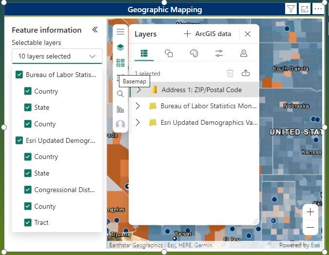

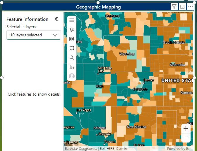

I am having the same issue with the "ESRI Updated Demographics Variables 2023" and "Bureau of Labor Statistics Monthly Unemployment (latest 14 months) as far as being able to interact with them in the Power BI map inside both Power BI desktop and Power BI online. They were working fine before the update, but now it doesn't show the pop up information when you click on a county, state, census tract, etc. I've enabled the feature information option and have those layers selected inside the feature information section on the map. Please help! ArcGIS Issue.JPGArcGIS Issue 2.JPG
DillionRoberts
I do see the information in the featured information panel now, but I just wanted to clarify, there's no way for it to populate inside the map?

Hi @BradCase1, please refer to the solution post above. Toggle on Feature information from the Format pane in Power BI, select the layers from the side panel drop down if you sign in as an ArcGIS user and click features on the map, then you should be able to see the popups on the feature information pane. Please let me know if you have more questions!
