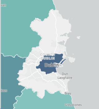

Hi all,
I'm having problems displaying the county of Dublin on a map. The rest of the counties are being displayed correctly, but the ESRI map for Power BI is only selecting the city section of Dublin and not the whole county.
I've tried most every combo I can think of to indicate its the whole county. Any thoughts?

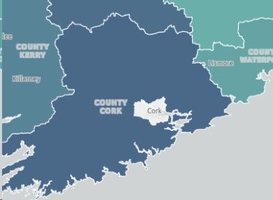

Looking closer at the map produced, it looks as if for Cork, the city is omitted (the opposite of what's happening to Dublin)

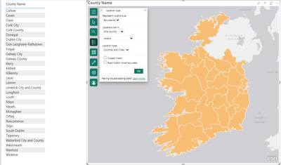

@ireladan - Thank you for the data! I had a look at it and saw the same behavior. I was able to recreate some of this data and it now appears properly in ArcGIS for Power BI. Please let me know if this dataset helps. I have added a screenshot to show how it should appear in the component.
In the Location type widget, ensure you select the appropriate data fields to render the boundaries on the map. You can use either Closest match or Exact match and the results will be the same.
