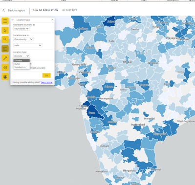

Hi there, (Power BI Desktop V. 2.103.881.0) Im strunggeling since a few days with the following:
I would like to create a colored(by a certain indicator) arcGIS Map of India (with state boundaries).
I did this for germany and it worked perfectly (Screenshoot 0), my way of doing it was:
1. choose arcGIS in power bi, add the location (post Ident Number, 6 digits; Screenshot 1); add the indicator for the color
2. Mark the Post Ident Number Column as Post Ident Number, so the little world icon occurs for that column (Screenshot 2)
3. open the layer manue on the top left, go to "positioning type" (Screenshot 2) choose boundaries (instead of points), choose single country and choose the specific country. Here comes my problem, I can choose all the country on the list, except india, if I try to choose it, power bi just keeps the previous choice. I simply can not choose india (Screenshot 3). Maybe someone of you had the same issue and could share the experience, solution, or ideas. That would be great.

@BLehmann - Hello there! My name is Anthony and I am a product engineer on the ArcGIS for Power BI visual. I was looking over this issue and I would like to help out if I can!
It looks as though this is a bug in our visual. I have used data on my machine (India Divisions) and you are correct! India cannot be selected from the dropdown menu.
I have logged a bug in our project and I will reply to this thread once I know this has been resolved. I apologize in advance for any issues this is causing. Hang tight, we will get it sorted out!

@BLehmann - Apologies for the delay in responding to this!
This issue has been resolved and you should be able to map to States now as an option under India. Please let me know if you have any issues!
