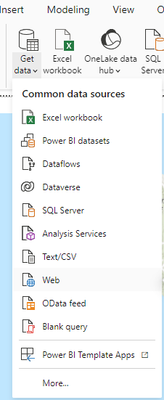

3. Home (in Power BI)>Get data>Web>Web views>Enable web previews>load data>check the files

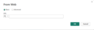

I'm trying to execute your instructions but cannot find what you explain in the 3d point.
After choosing web, there is no other option to choose. Which means that I miss "Web views>Enable web previews>load data>check the files" part. Please help.
After choosing "web" I het the following screen:
Please help.
Kind regards,
Cesar
Faiez
Hi Cesar!
Just write the URL, from where you want to bring more data, otherwise you can continue with your excel data. It provides additional sources.
Best,
Faiez
