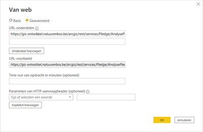

Thanks voor your answer. Nevertheless, if I try to connect to a rest service, I get a standard column, and I don't see how I could retrieve the Shape field in order to "drag it into the location field".
then i get this
Do you have  more detailed information or documentation how to connect in a way it works?

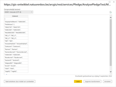

Yep, me too.  I need to use an off-menu feature class of an organization's administrative boundaries that are not in the list of recognized boundary types that the geocoders can find and supply.  I can query the hosted map service in ArcGIS online and return EsriJSON in WGS84 with all fields like this:
I'll note that there is no such thing as a "Shape" column in that EsriJSON above, so I'm guessing that the help documentation is referring to what Power BI perceives as the Column1.attribute.geometry column.

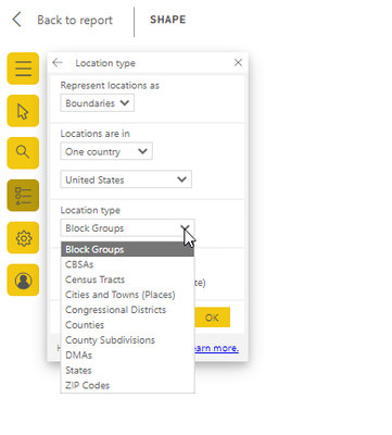

I can tell Power BI to load JSON, then get Power Query Editor to convert it to a table thingy from which I can load that Column1.attribute.geometry (or "Shape" when I rename it) into the Location well for an "ArcGIS Maps for Power BI" visualization, which then erases the basemap, creates a white canvas, and tells me "The accuracy of your locations can be improved (hint - not by any existing Power BI map visualizations, they can't) and presents a "Go to Location Type and learn more." button.  I click the button and fill out this thing, which does not seem to understand what's happening:
Clicking that "OK" button results in a briefly spinning spinner.  Any pointers on how to get Power BI to use an EsriJSON file (or any approach, really) for using off-menu boundaries and columns like what one would find in a SQL Server enterprise geodatabase feature class that Tableau or ArcGIS can use (i.e. WGS84, SQL Server geography spatial type) would be greatly appreciated.

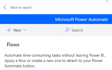

2. Add a Power Automate for Power BI Visualizer next to the Map.
3. Edit the Power Automate to create a new flow. Click on "New"
Select the "Instant Cloud Flow" option

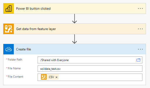

4. Add flow steps to the "Power BI Button clicked" button

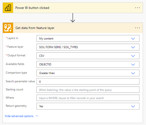

- Click on "New Step" and search for the "ArcGIS" functions
- Select "Get data from Feature Layer" action
- After the step is added - use the ...(3 dots/ellipses) on the step to create a ArcGIS connection - important for authentication.
- After login you should be able to use the dropdowns to select the "Layers in" and the "Feature layer" you want to use.
- Select "Output Format" as CSV
- To ensure all features (up to 150) are extracted set OBJECTID field, Greater than, 0
5. Write CSV content to a File and folder location
- I added a OneDrive - Create File action
- Add Location of the file
- Add the name and extension of the file
- Add content type - Select CSV from the list
6. Save the Power Automate Flow
