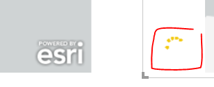

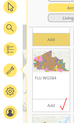

I published and hosted a feature layer on the ArcGIS Online organization account and the layer is visible on both the online Map viewer and also in the Power BI list of layers.
Feature Layer in ArcGIS - Shared with public
Power BI Add Layer:
However, this layer is not loading in Power BI and nothing happens after adding this layer. I tried different projection systems, zoom in & zoom out, and checked the shared option with everyone. Still this layer is not loading and showing the yellow circle after adding it:
How to fix this issue? Is it because of recent Esri updates? Is there any way to download GIS for Power BI in a separate file?

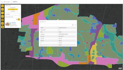

@RezaSardari - Hello there! My name is Anthony and I am a product engineer on the ArcGIS for Power BI visual. I was looking over this issue and I would like to help out if I can!
I did a quick search for the item you listed in your post (FLU WGS84) and was able to find it in the public listing. I tested this in our latest version (which should be out in the next week or so) and it appears to load properly.
Let me know if this helps! If there is another map that you'd want me to check, send the mapID here and I can load it up to see if it adds properly.

AnthonyLatini
That is correct. We should know more in the next 2 days if they can still get it out for the 29th or if it will delay to October 6th.
I had a look at this layer in our current version, v1.0.0.110 (the visual that is currently in Power BI Online and Power BI Desktop) and it looks like this is a bug in this particular version. Unfortunately, there wouldn't be a workaround in this version. However, the new version has resolved this bug it seems!

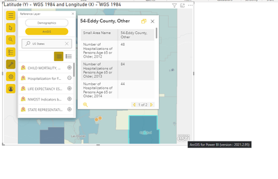

@Rudolfde_Munnik - Hi there! Our newest release should be out and live within the next 48 hours. The live date is December 8th 2021, but it takes a bit to roll out to everyone who uses Power BI. The newest version of our visual is 2021.2.95. When you hover over the Esri logo in the map, you will be able to see that version number.
Let me know what happens when you see the new version.

Thank you for the feedback and continues support. The version 2021.2.95 is now updated on my Power BI Desktop. I am now able to open previously saved reference layers. I am assisting a consultant of a local authority who need to sign-off on a Power BI integration project deliverable. Just in time. Thanks
