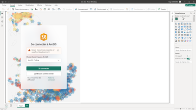

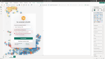

Hi @AnthonyLatini,
Unable to connect to ArcGIS for Power BI since update (2024.1.400) :
  • Error message for ArcGIS Online : Cannot read properties of undefined (reading 'error')
  • ArcGIS Enterprise URL not recognized : The ArcGIS Online (or ArcGIS Enterprise) URL specified is invalid.
BrettMartin1
@hgaignard I saw this with an older version of desktop app after update with Enterprise only. Worked fine in the newest version.

@hgaignard @BrettMartin1 - Thank you for reaching out on this issue!
Because of the complexity of this update, there is a chance that there is something cached in the WebView2 and Cache folders in Power BI Desktop and in Power BI Online. This error when signing in is caused by the cache. Please run through the following steps to clear the cache.
ReferenceClear the browser's local storage—ArcGIS for Microsoft 365 | Documentation
  1. On your local system, depending on how you installed Power BI, browse to one of the following folder locations:
    • .exe version—%LocalAppData%\Microsoft\Power BI Desktop (for example, <user>\AppData\Local\Microsoft\Power BI Desktop)
    • Microsoft Store version—C:\Users\<user>\Microsoft\Power BI Desktop Store App
  2. Delete the CEF folder.
  3. Delete the WebView2 folder.
  4. Delete the Cache folder.
  5. Restart your machine.
