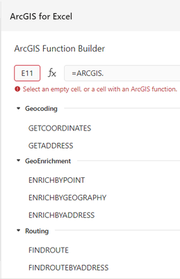

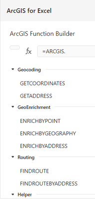

The Function Builder opens in the Task pane, with parameters listed under categories.
Note: You need to sign in to ArcGIS to access the Function Builder tool.
4. If you have chosen a populated or an empty cell, the selection or an error displays before you can proceed with a function selection.

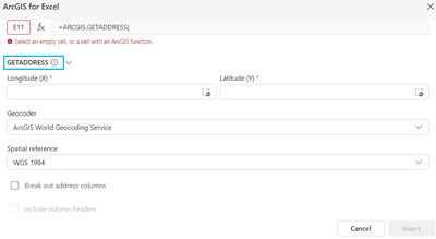

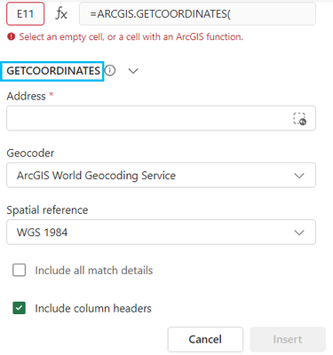

Geocoding functions:
Parameters: (all fields with an asterisk, are required)
GETADDRESS
GETCOORDINATES

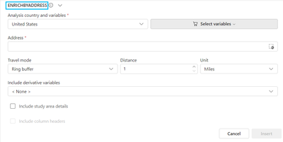

 ENRICHBYADDRESS

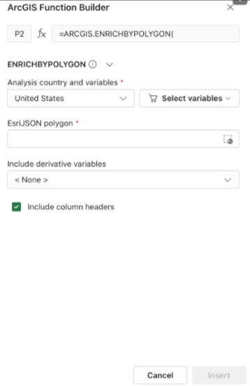

ENRICHBYPOLYGON

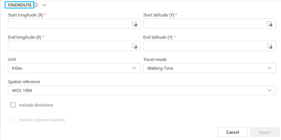

FINDROUTE
FINDROUTEBYADDRESS

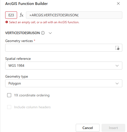

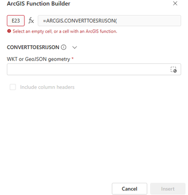

Geometry functions:Parameters: (all fields with an asterisk, are required)

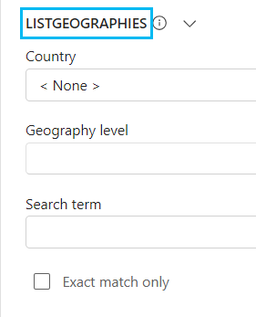

Helper functions:
SUGGESTADDRESS
GETGEOMETRY
LISTGEOGRAPHIES

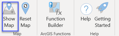

7. Once your Excel sheet is populated with information, do one of the following to return to the map frame:
Click x, or click Show Map. You may also toggle between the two ArcGIS for Excel icons to switch between Function Builder and your map.

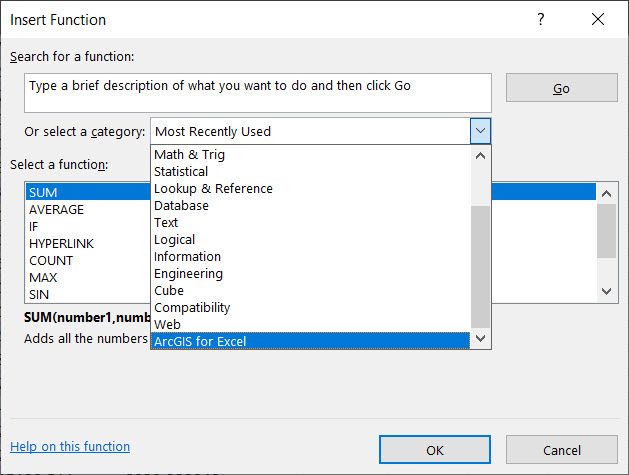

VojtěchBlažek
Functions dont work after last update. I can't see function when I hit =arc - only geometric formulas are shown.
ShannonCardoza
@VojtěchBlažek Good morning, my apologies for the delay in response. Can you verify what version you are currently using? Also if you select fx in the formula bar, do you see ArcGIS for Excel as an option when using the drop-down menu option from 'select a category'?
Thank you!
-SC
