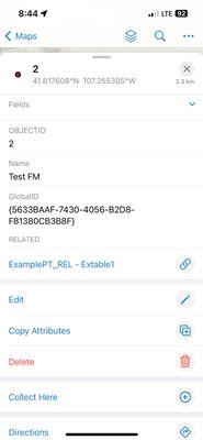

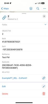

Yes it does?
PointRelated record
I got the lat/long conversions from @JoshConrad1 here: Re: Collector (Aurora) Custom Expressions in Custo... - Esri Community
//Lat
var relF = FeatureSetByRelationshipName($feature, "exPoint1")
var ref_id = $feature.RelGUID
//This may be different for 1:M relationships?
//Idk I didn't test it.
relF = First(Filter(relF, 'GlobalID = @ref_id'))
var lat
var originShift = 2.0 * PI * 6378137.0 / 2.0
lat = number(Geometry(relF).Y / originShift) * 180.0
lat = 180.0 / PI * (2.0 * Atan( Exp( lat * PI / 180.0)) - PI / 2.0)
return lat
//Lon
var lon
lon = number(Geometry(relF).X / originShift) * 180.0
return lon
My test data was in WGS84, so your mileage may vary here.
Couple things I had to figure out while doing this:
  • Make sure the relationship is not globalid:globalid. it should be globalid:guid.
  • Make sure this setting is checked
In any case, it may in fact be simpler to just use a related feature class, but if you want to use a table, this does work.
