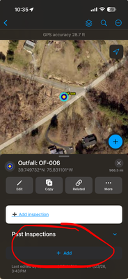

I have a hosted feature layer published from S123 Connect onto ArcGIS Enterprise. I have a URL parameter in the point layer pop-up on the web map for the user to click the link and edit the point as well as the related inspection table (repeated section) in the form. I want the popup to include past records. Is there a way to remove the "Add" button in the popups in field maps, since I only want them to access the S123 form through the link?

@SarahSaint-Ruth I have a similar set up in AGO where a survey123 survey edits related records on a hosted point layer. I would like the submitted surveys to be visible at the bottom of the popup, but I also only want new records added through the survey123 link in the popup, not through the add button in field maps. This seems like it should be a setting in field maps designer.
Edit: I need the parent HFL to be editable, but related tables to not be editable. There doesn't appear to be enough granularity in the settings to allow for this. I can only allow/disable editing at the HFL level, applying it to everything, not at the individual related table level.
