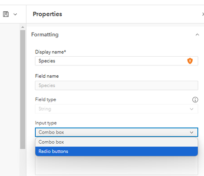

Also, according to this post, you need to have a default value set in order to use radio buttons. Then you can just go into the form designer and choose radio button from the option:

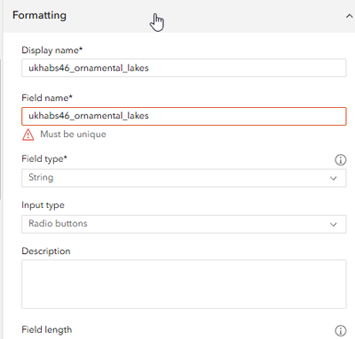

Thank you. I am using field maps designer from a hosted feature layer.
When i add a radio button and type the field name it says it must be unique. The field has a default value set

Ah, I actually haven't ever constructed a form this way, mostly I drag the field into the form and then set the input type. I assume you have a domain applied to that field?

Hi, it was my mistake. I needed to add the field and then change its type to a radio button type! I was adding a radio button form element!

After a quick test, I got the same thing as you when I added a radio button, but if I added the field and then selected radio button, it worked out just fine. Can you see if it makes a difference in yours?
