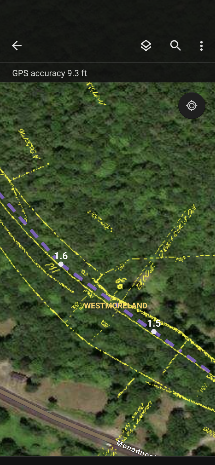

One of two tiled image layers appears blurry in Field Maps but just fine in an Instant App. In field maps, the layer does load in the pre-made offline map but it is not legible and new tiles are not loaded when zooming in and out. This layer was published from a raster catalog and I have seen the same issue in both an Android and iOS mobile device.

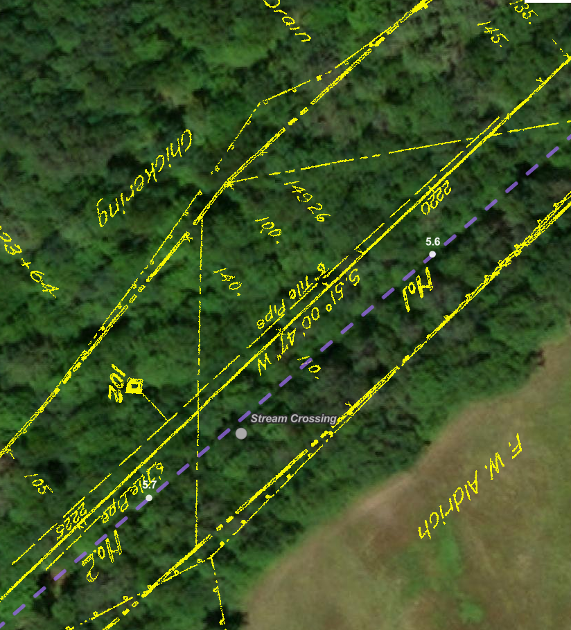

Here is the online map - it looks great even when zoomed in.

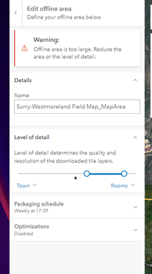

The first image above is from a preset offline area. I learned that when I add an offline area manually in the device set to "Rooms" I seem to get that level of detail from the valuation map tiled layer which is now clear. The problem is that there would need to be dozens of manual maps for the same area...

Ahhh found my problem! I missed a setting...
