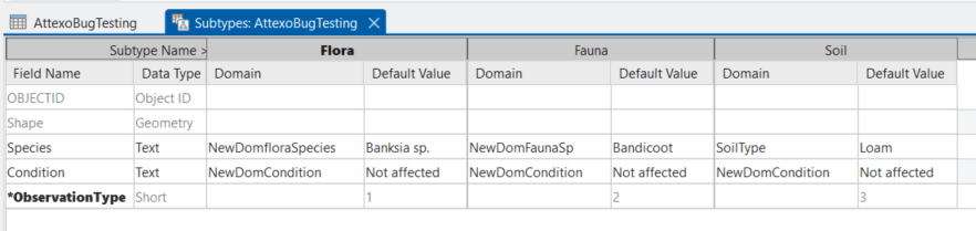

When working with Feature class where domains applied to subtypes, I found domain list is missing in the Field Maps.
For example, I have a feature class with three fields - one subtype field and two text fields named 'species' and 'condition'. 'Species' has three different domains applied, each relevant for a subtype. 'Condition' has one domain applied for all subtypes.
This is what the schema looks like:

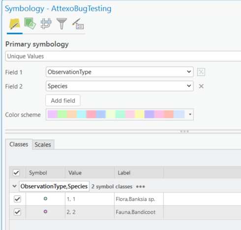

  • The feature class is created to collect data in field using Field Maps. Therefore, I applied Unique value symbology using the subtype field "ObservationType", symbology classes correctly populated. However, I require to add one more field to symbology be it 'species' or 'condition'. As soon as I add another Field, the symbology classes disappear from the Symbology Pane.
  • This issue is reported in BUG-000173677 for ArcGIS Pro
  • Following the workaround suggested in the Bug-000173677, I added two points for two of the subtypes. This triggered the symbology classes to appear for the two subtypes. Then I published the feature class.

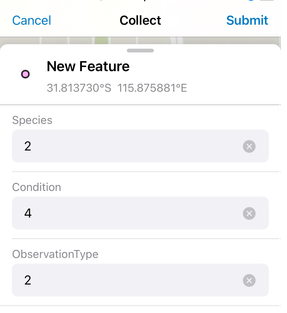

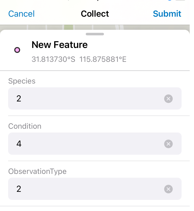

  • When I opened this Web map in Field Maps to collect data. I noticed my two symbology classes are available, I selected Flora,Banksia sp. option to collect point but I could not see any dropdown list or a description. The fields were only prepopulated with the default codes for subtype and domain.
I tested applying symbology using two fields on different datasets with similar schema but cannot get a dropdown list for domains in the Field Maps.
