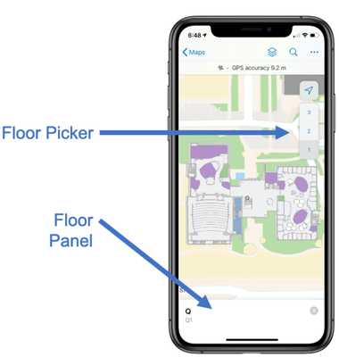

Is it possible to modify the contents of the Floor Panel?
I'd like to add some additional attribute contents as well as a link to Survey123.
Thanks!
MiaogengZhang
The floor panel content is from "Name" field at Facilities layer and "Name" field at Levels. You can see this help for more info: https://doc.arcgis.com/en/field-maps/android/help/indoors.htm
Could you describe the scenarios how you will use those info? You can consider adding ideas site too into https://community.esri.com/t5/arcgis-field-maps-ideas/idb-p/arcgis-field-maps-ideas
Andrew-Bowne
Hi Morgan -

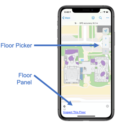

What I would like to do is add a link to launch Survey123 so a user could perform an inspection on the level of that floor.  I know that I could create a custom popup for the level but that would require an extra tap.  It'd be nice to have that link display right when the floor is picked..
Something like this:
