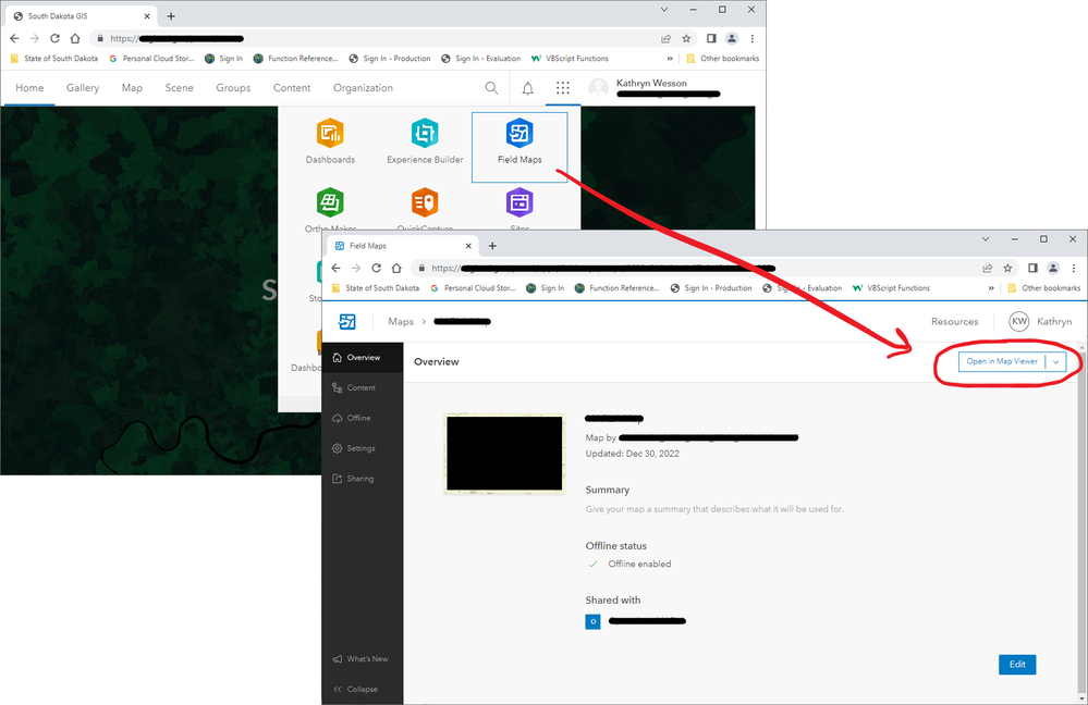

Are you making any additional changes to the web map after configuring the Field Maps form? I was having a problem where I would set up and save my form, then go back to my Portal homepage and open the web map to tinker with the feature symbology, then save the map and log out for the day without checking the form again. Then I'd come back to my computer in the morning and see my form had magically disappeared overnight. Turns out...
If you need to make any changes to the web map (adding new layers, changing pop-ups/feature symbology, etc.) you have to go through the Field Maps website to preserve the form settings. Like this:

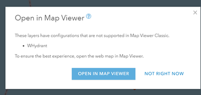

RussRoberts
Esri Notable Contributor
You can open the web map in Map Viewer through Field Maps Open in Map Viewer or the Web Map item > Open in Map Viewer.
If you open the web map in Map Viewer Classic and save the map these unsupported properties will be lost bc the web map will be downgraded. Example properties you would see dropped are forms, group layers, effects and vector symbols  You can set Map Viewer as the default viewer under the org settings to limit the chances that Map Viewer Classic changes impact your map.
https://support.esri.com/en/technical-article/000028040
