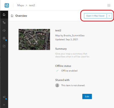

@DebHSF , have you tried modifying the map from within the Field Maps web app, rather than in a separate map view?
This map is opened inside the app, so should preserve field maps settings.
You may already know this, but you can't save over a field maps map with the classic map viewer, or you'll lose any of the smart form customisations.

Are you making sure you refresh map viewer after you make changes in the Field Maps app? Both apps are updating the same map so it's possible you are accidentally overwriting the changes using a "stale" map when you save in Map Viewer.
You can open the map in Map Viewer or Map Viewer Classic directly from Field Maps on the Overview page.

Thanks @David_Brooks, it does preserve the settings/configuration if I access through the Field Maps web app. I hadn't spotted that button before.
@Anonymous User so if I open and save either the new or classic map viewers, the Field Maps settings should still persist? Should that be the case when I am opening the web map from My Content as well as through Field Maps>Open in Map Viewer? Or is through Field Maps the only workflow that we should use?

It will persist in either map viewer regardless of how/where you open the map. If you open Map Viewer directly from Field Maps, after you make changes, Field  Maps fetches the latest changes you just made so it's always in-sync.
Where you can run into issues is if you have 2 tabs open. One with Field Maps and one with Map Viewer. If you make changes in one of the apps and save it, then you have to manually refresh the page of the other app in order for the changes to be picked up. If you don't do that then, if you make a change in the second app and save - the changes made in the first app will be lost.
