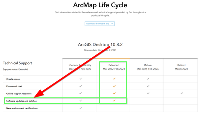

@JakeBrownMaps Why is ArcMap not on your list?

ArcMap entered mature support this month and is getting retired in 2026. No development and increasing divide between it and other parts of the platform like Arcade and Map Viewer. There's been a migration to Pro push for at least 4-5 years. Existing users should be looking to move off it ASAP and new users should not be considering it. No one should be recommending ArcMap, especially Esri staff.
Technically, ArcGIS Pro better supports web map workflows for publishing, online and offline. ArcMap is not comparable.

Yes, I am very aware of the ArcMap life cycle and Pro push. We are a power utility. So, we will not be getting off ArcMap for a number of years as the migration to the utility network is a major undertaking. I think for us it makes the most sense to just deploy ArcMap to the devices with fgdb dump of our SDE for offline use. And then use a Portal web map or app for online use. That way we can use the same mxd on the device that the web services are based off.
