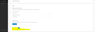

Hi @karyn_rosa123 there's a setting ready for you to use today in Field Maps Designer that will prevent folks editing multiple records at once.
Open Field Maps Designer from your app waffle - select the map you want to prevent edit multiple in go to App Settings and under Map you will see the toggle to enable or disable edit multiple.
