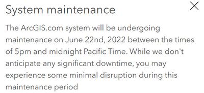

Their is announced a System Maintenance for the ArcGIS.com system today. Would there by any chance be updates for this issue?

As of yesterdays ArcGIS.com system maintenance June 22nd we can happily say that Contingent Values are working in our new created offline areas this morning. We can also see that new functions has been added and we are looking forward to hear more about the new updates.
