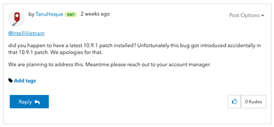

Hi @RenatoTeixeira1 Thank you for the information.
And just for clarification, you're using ArcGIS Enterprise 10.9.1 and not 11.1. Is that correct?
The posts you mentioned above refer to the users upgrading to 11.1 and seeing this behavior. There was a patch that was released to address that issue. Here is a link to that patch for 11.1 - https://support.esri.com/en-us/patches-updates/2023/arcgis-server-11-1-map-service-and-custom-data-f...
However I am not familiar with this being an issue at 10.9.1.
I just tested with a map that contained a layer named Point é on iOS and the layer loaded fine using 10.9.1.
Can you share a screenshot of the layer failing to load in Field Maps?
Can you also share more details related to the update that you installed?

Thank you for sharing that information @RenatoTeixeira1 .
At this point this does not appear to be directly related to Field Maps, but rather 10.9.1 as you've stated.
I will continue to look into this issue internally on my end and will follow-up when I have more information to share.

KevinBurke
Thank you for that information @RenatoTeixeira1. I just confirmed that the patch you installed does not include this fix. There will be another patch to address this in the coming weeks. I don't have an ETA, but will let you know when it's available.
