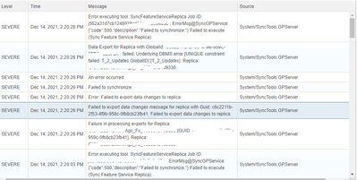

Hi, I am getting these error, when i try to download or update Offline Maps in ArcGIS Field Maps. First time it was working as expected. Later on when i try to update these, I am getting these errors. I have to recreate Managed areas again to work properly

Your ArcGIS Server errors would indicate that the SyncTools utility service has encountered a parameter within your web service that doesn't comply with syncing the replica.
I would recommend reaching out to Esri technical support. We would need a lot more information to pin point what might be causing this issue, i.e:
