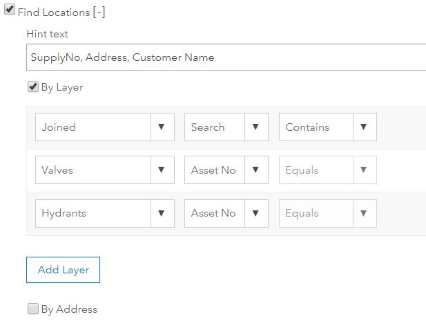

Since the latest release 17.1.0(1755) of Explorer for ArcGIS on OS the ability to search by a layer within the app does not work.
We have 3 layers set under the map settings;
Layer Settings
Via the browser this still works giving results but on the devices just results from the Esri Geocoder.
