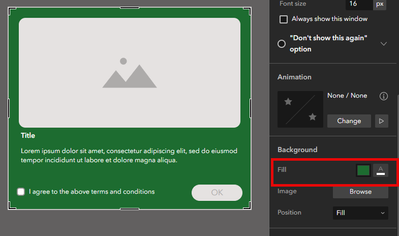

Splash Window. How to change the font color in this message "I agree to the above terms and conditions"
719
01-15-2025 11:43 AM
SanchezNuñez
Good afternoon,
How to change the font color of the message 'I agree to the above terms and conditions' in the Splash Window?
Thanks
4 Replies
DavidPike
MVP Notable Contributor
This is just from me spending a few minutes looking at it, but it doesn't seem to be possible in the builder.
Laura
by MVP Regular Contributor
NicoleJohnson
A couple workarounds, first the not-terrible one, second the terrible one:
  • Just don't use the default "I agree..." text and checkbox. You can make your own button that says, "I agree...". Removing the checkbox (which of course doesn't actually do anything in the first place) also saves the user a click. Set the button to link to Page --> Current page (this avoids problems caused by setting it to the home page; someone could send a link to a specific page to someone else, and by linking to the "current page" the splash screen has no bearing on where the user ends up).
  • You can't change the font color for this text directly by customizing a theme, but the different themes offered do present this text in different colors. If you had to have the default text for some reason, you could choose whatever theme gives you the font color you want (as long as that's white, black, or some version of gray, which is what the themes offer), then re-assign all your other theme colors.
ShengdiZhang
In the October 2025 AGOL release, the window supports setting the foreground color, which also affects the confirmation text.
