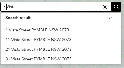

I have a strange problem. I am trying to search a simple layer that has addresses in it but it will not give search suggestions for low numbers in a street. For example 3,5,7, or 9 Vista Street PYMBLE NSW 2073 will not give any correct suggestions. It happens for low numbers on most streets. I am not sure why this is happening?
Here is a sample of the problem:
Any suggestions would be appreciated.

So this appears to be normal behavior for Experience Builder. For a full explanation please see this post
https://community.esri.com/t5/arcgis-experience-builder-questions/full-text-search-index-on-hosted-f...
But the solution is to remove the Full-text search index from the attribute you are searching. Experience Builder will automatic add a full-text index to be helpful. So, go to layer settings scroll down to Manage indexes click Field indexes then delete the full text index.
