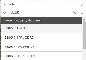

A side-question I have is about the candidate list that appears if a user enters the direction "s" when using the web map JSAPI search. In this example if I just type "3805" I see 4 candidates (which is correct):

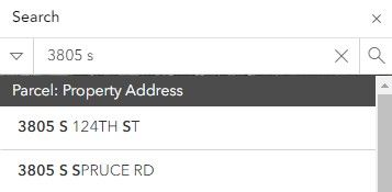

If I type "3805 s" then I only see 2 candidates and note that they are ones with words that start with "s" later in the string:

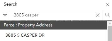

And finally if I type "3805 casper" it finds the correct one. This is actually the ideal behavior and what I would expect from a full text index. But I am still curious why "3805 s" does not show 4 candidates.

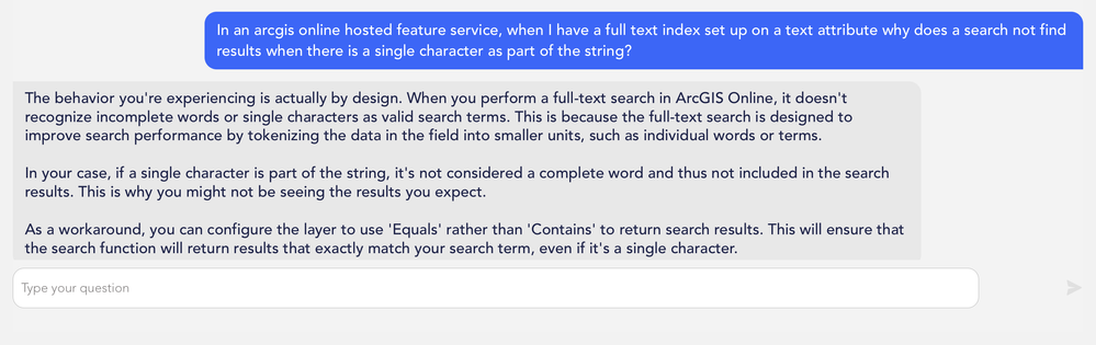

I recently asked the Esri AI Chatbot (in Support app) about the single-character string search problem. It's answer was that the search "doesn't recognize incomplete or single characters as valid search terms." Not sure where the AI sources that but it was an interesting response.

Thank you for the detailed test.
I have double-checked with the corresponding team and their response is the same as the Esri AI chatbot. Since a single letter is not a word in the dictionary, it will not be recognized as a valid search term.
We have made a relevant fix in the latest AGOL update (in Experience Builder only) that will not send single letters as search terms.
