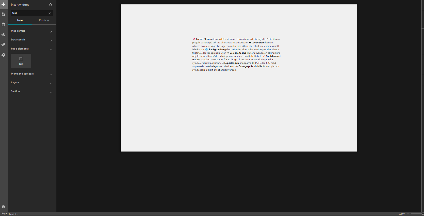

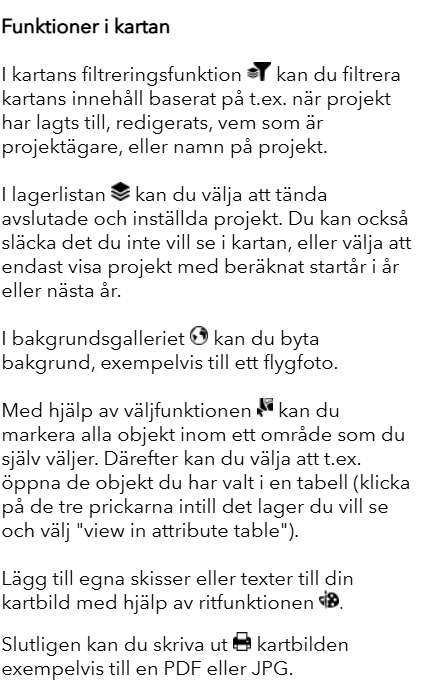

Have you tried copying them directly into the widget using Ctrl+C and Ctrl+V?
I just tested it with various texts containing different types of icons, and they all displayed correctly.
Example attached
