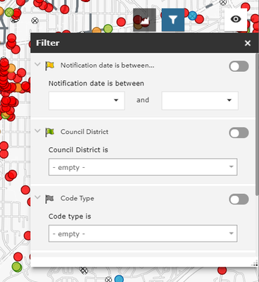

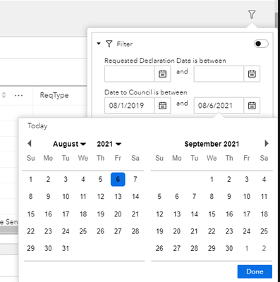

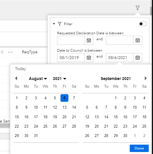

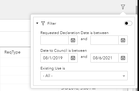

Hi all, I probably missed a setting somewhere. But I'm unable to figure out how to clear or reset a date filter to no value after selecting dates? Of course I can turn the filter off, but the date values remain, so that when I go to turn the filter back on for something else, the dates still exist and I must have dates selected.
The attribute filters I can manually set back to "All" or similar. But what am I missing when it comes to dates?
A "clear all" would be great too.
Thank you! Screenshots are from ArcGIS Online.

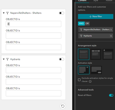

@BrittanyBurson @JonathanMcDougall The reset all filters function has been provided with the latest AGOL 10.2 release. Now as long as the default value is empty and configured properly, the reset button can achieve the goal of clearing all user input:

I'd take the simple approach and remove the date filter moving it to its own filter. What you've created above is a group of filters that are intrinsically linked, not unique therefore you are asking the user to always make three choices.
BrittanyBurson
Thanks for the suggestion, I'll consider this. They're setup to use "OR" and the user prefers to access them all in one click/one place. In Web AppBuilder, each filter can be toggled on/off uniquely while using a single Filter widget. So to really get around this, I'd have to use a unique filter widget for each date. Or refresh the page each time.

Yeah, fully appreciate the user wanting only one interaction, makes sense. The filter can be applied to the Framework, so this means still only one date selection interaction.
TonghuiMing
Hi @BrittanyBurson - this is the same issue as discussed in this post - Custom Filter widget to reset filter. It is something we haven't supported yet but a potential ENH we will take a look in the near future. Keep tuned.

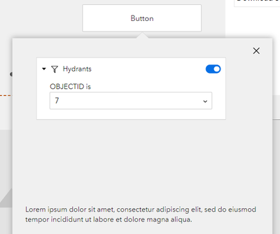

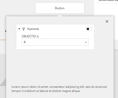

@BrittanyBurson - Oh and a workaround - currently, if you put the Filter widget (ExB) into a window, and when you close the window, the values got reset:
Note that this behavior might change in the future.
