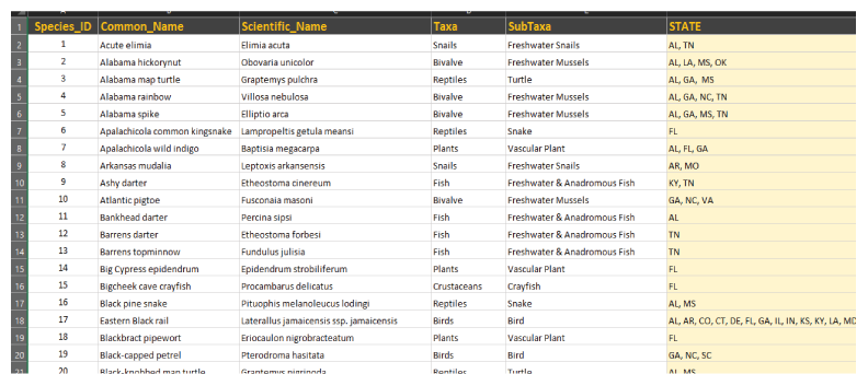

I clearly understand the workflow. Thank you so much! I created the list that allow me to select multiple States...that work great!. However, if I use this workflow,  I will have to duplicate the records many times for each state. I have 18 states with 2,099 species.  The result will be an extremely very large table with duplicate records and a very long list of species for the filter. I don't see anyway around to support this many- to-many relationship.
JonathanMcDougall
How's your species data held? Are you able to share a grab of a few lines? You wouldn't be creating duplicate records, just ensuring the right species has the right state - you're data would be no bigger than it is just now.

JoseBarrios1
I am confuse... Attached is a small excel sample of the species table structure. The species occur in many states as shown in "State" field. sp_list.png
