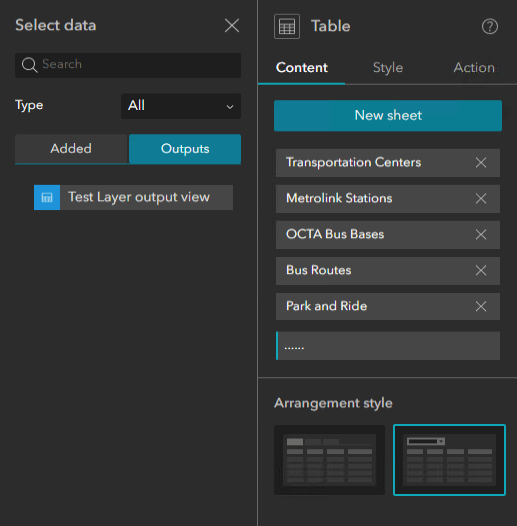

I can see this output in the settings page of other widgets. So, for example, I can add it as a "New sheet" to the Attribute Table widget and the configured schema looks correct.

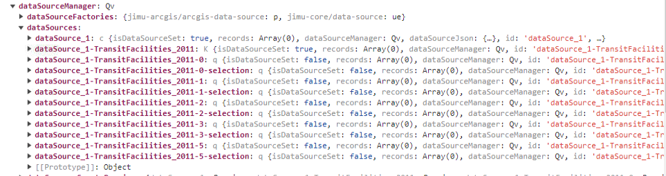

However, I can't figure out how to access this datasource and update it's records at run time. I can get a reference to the DataSourceManager and see all of the other datasources in the app but my custom output datasource doesn't appear.

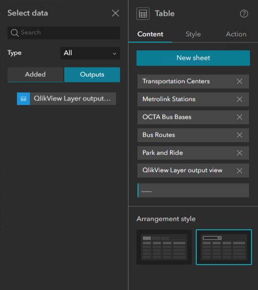

Then I added the output datasource as a new sheet in my attribute table widget.
