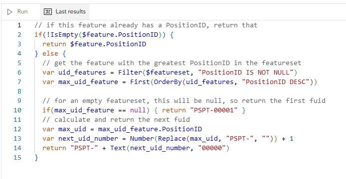

I have arcade set up in a smart form to auto-generate the next unique ID when a new feature is created. When updating an existing feature, the script should use the existing unique ID. This works great in Field Maps and when the arcade script is tested. However, when editing through Experience Builder, the arcade script always generates the next unique ID and replaces the existing unique ID.
Arcade Script:

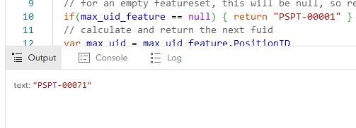

Arcade Test (the next unique ID based on my features would be PSPT-00089. PSPT-00071 already exists, and the arcade script is working correctly)
