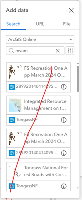

Add Files widget, Search subtab very much needs the combo of options added, which are in WAB version, specifically to return results based on Relevance. (All combo options: Relevance, Title, Rating, Views, Date.) The return order of results is nowhere near as handy for finding the best, most authoritative result. Example: "MVUM" should return USFS's authoritative version of the MVUM service on top of the list as it does in WAB version. The same result is something like 70th deep in the list in the ExB version. (PS: I would wish for fewer clicks to finally add a layer, and a more-visible Delete Layers trash can or menu item. But I think I understand why it was done this way versus the WAB version, and it's thus more just getting used to a different way of functioning.)

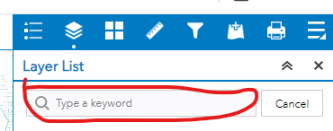

@Jianxia  Webapp Builder layer list search function  is already available or plan in Experience Builder
Jianxia
@DevDesai, the search function is available in the Map Layers widget in Experience Builder in ArcGIS Online and ArcGIS Enterprise 11.3.

@AlexErnst_IDPR  , thank you for your feedback.  Could you please submit an enhancement to Esri Support for the combo of options in Add Data like its counterpart in WAB?

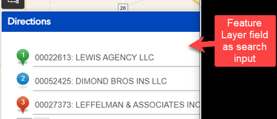

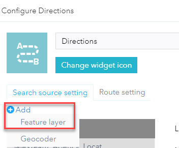

@Jianxia Are there any plans to add these items to the Driving Directions Widget in Experience Builder?
1) Print Driving Directions
2) Driving directions segment times (not just total time). For example, I have 3 stops, what is the time to each stop? This is currently available in WebApp Builder Driving Directions.
3) Feature layer as routing input.

@CaroleC , these capabilities in the Directions widget have dependency on Maps SDK. Your request has been added to a backlog issue.

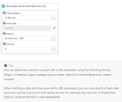

Thank you for the list. @Jianxia, are there plans to enable preset values based on url paramters in the Map Viewer's Smart Forms/Experience Builder's  Editor Widget? That functionality exists in WebApp Builder (Documentation😞
This functionality is especially useful to mantain ID-consistency between a non-spatial database (for example administration tool of an authority) and the according GIS-representation.

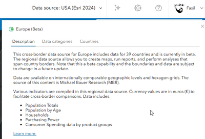

@Jianxia @AlixVezina hi and thanks so much for sharing those comparison matrixes, they were extremely useful! I also have a question about the BAO widget which I don't see on the matrix, but it's certainly there.  Do you have any pipeline notes? I am keen to have similar functionality as it is in WAB (e.g. depending on the geography, the tool would retrieve the reports available), at the moment I need to set up my country even if i am working on multiple ones. I saw the Europe option being in BETA in BAO, but still not here... I take any advice for a workaround in the meantime 🙂
Thanks!
FasilTiru
@SusanaGasquez The BA widget in ExB will support the new Europe data source sometime in 2025.
Currently, the BA widget in ExB is working similar to the BA Web App (bao) to allow you specify a country and data source. This is very important feature as some countries offer multiple data sources (vintages). With regards to a workaround, it depends on which countries you are working with and the data source used to create the infographic for those countries. For example, the following ExB app contains a BA widget configured with the What's in my community? infographic. This specific template is built with Foursquare data that is available across multiple counties. Although the default setting is for United States, you can use this app in multiple counties by using the search bar or manually dropping a pin.
https://experience.arcgis.com/template/fe920ba4c38c4124bd4c0a70e6296072/page/Page/
Melbourne, Australia
Berlin, Germany
So basically, if your infographics is built from a data source that is available in multiple countries, you should be able to use that template across different countries. Please feel free to post any additional questions specific to the Business Analyst products under https://community.esri.com/t5/arcgis-business-analyst/ct-p/arcgis-business-analyst
