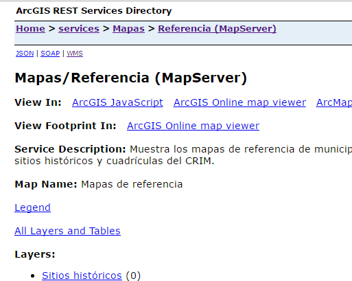

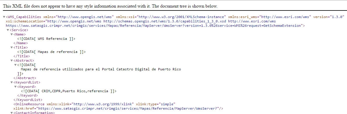

I have several MapServer services with WMS capability. For some reason If I use a not secure service and clic wms it works fine.

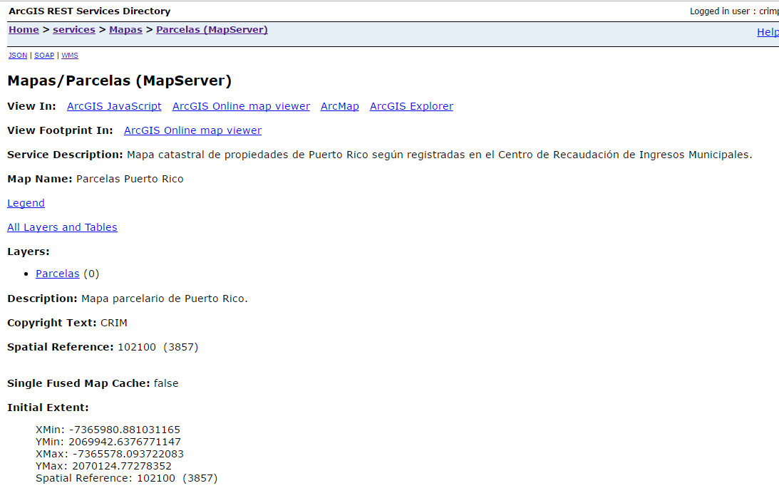

But, when I use a secure service, login to my rest point and clic wms it doesn't do anything, just a blank page.

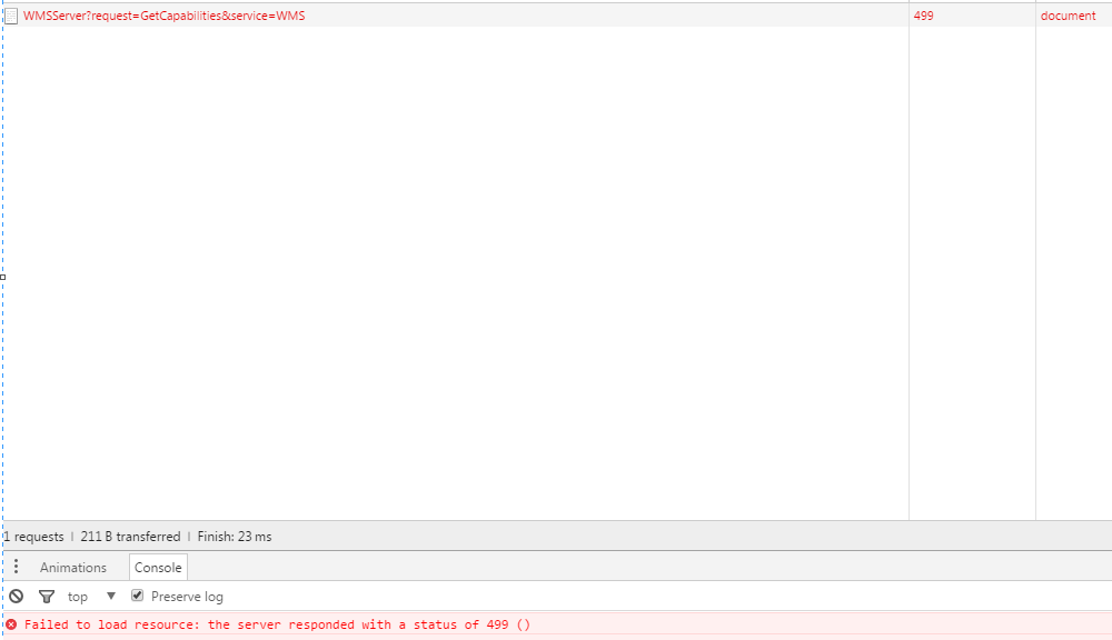

When I use fiddler I am getting the erro: Failed to load resource: the server responded with the status of 499

A 499 error is a "Token required" error.  I think you'll need to pass in a token with the request.
Ex.
http://<WMS_service_url>?<standard WMS parameters>&token=<valid_tokenString>
