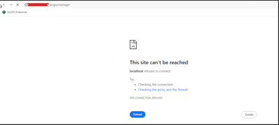

When you say the Server Manager is no more accessible, what message are you getting?  Share a screenshot maybe..
Try accessing the Server Admin page.  Does that work?

Yogesh_Chavan
Hello @Asrujit_SenGupta , thank you!!
Kindly find the screenshot below:
https://domain.com:6443/arcgis/manager
https://domain.com:6443/arcgis/admin
does not work.
