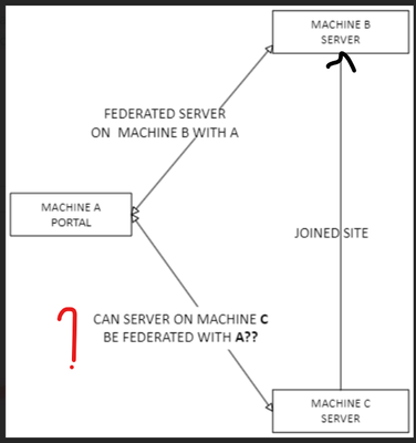

Just a side question I have. Does a joined machine to a server site also be federated to a Portal?
Thank you once again.!!
hlindemann
Hi  @Yogesh_Chavan, a joined site will be in an Active-Active configuration e.g. they syce between each other the config-store and directory needs to be on a network share and the servers needs the same service account, the second machine will automatically be added to your federation, I would advise to then federate using just the web adaptor.
Yogesh_Chavan

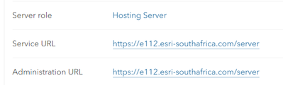

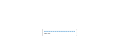

Hi @hlindemann ,
I have a server site with web adaptor installed on machine A and there is another machine B with server installed and joined to machine A.
We are observing that after federating machine A with portal (on machine C), machine B just goes into please wait mode. If we un-federate machine A this issue does not happen and machine B works fine. What is triggering this? We tried reinstalling, issue persist.
Thank you!!
hlindemann
Hi @Yogesh_Chavan can you give me some more context on the end point you are trying to hit. is it webadaptor/manager or https://dns.com:6443/arcgis/manager  ?
Regards
Henry
