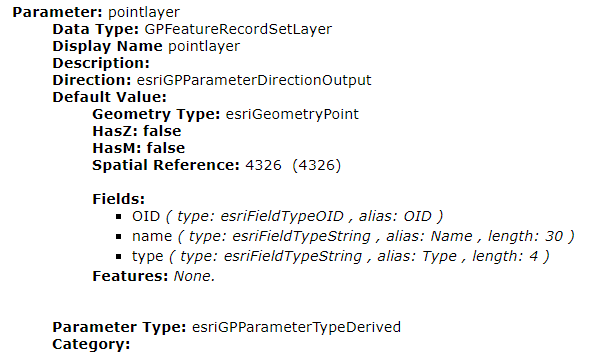

I have run into this on several occasions, with different versions of Pro and Enterprise. As a test I have written a tiny Python toolbox that creates a point layer with one fixed point, the toolbox runs in ArcMap and Pro.
When I publish the tool as a Geoprocessing Service to ArcGIS server (10.6) from ArcMap (10.6.1) the output layers has schema and geometry type.

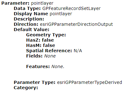

But when publishing the exact same tool as a Web Tool to the same ArcGIS server from Pro 2.4 this information is lost.

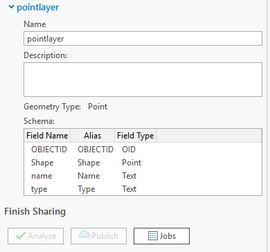

Even if the information are present in the Share as Web Tool dialog in Pro.

Retested publishing of the tool today using Pro 2.7.0 and a 10.8.1 Portal and it seems like the problem is solved now 😊
