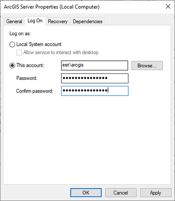

Hi @MattCashen
After the domain account password has changed, upon a service restart cause the service not to start successfully.  If it's only a password update, you can do this within the Windows Services:
However, if the username itself were to change, you should use the utilities you mentioned.  This will grant the new domain account the necessary privileges to the required directories.

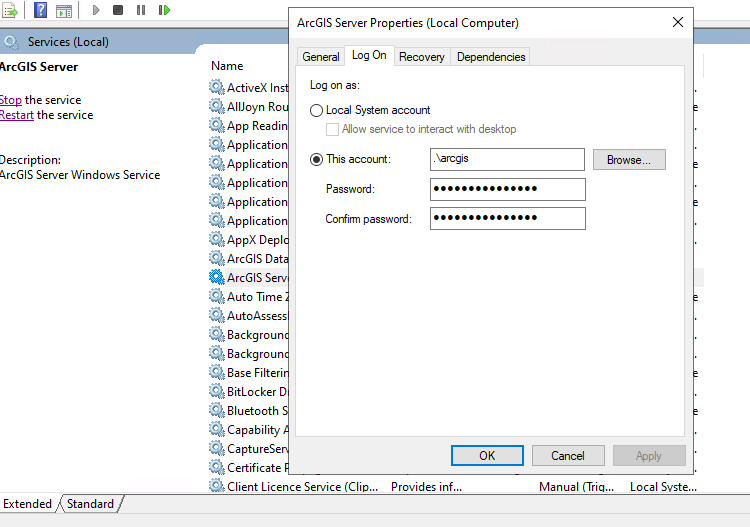

Priya_Das
Hi @MattCashen
If  the domain account password has changed or reset. Update the password in Services - By selecting ArcGIS Server , Portal and Datastore logon with correct password Screenshot 2025-06-11 154725.pngand Restart the services.
Run 'Configure ArcGIS Server Account' - If notice you are unable to access Manager endpoint
