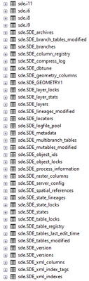

I don't know which ones were deleted, but I believe some are missing:
What purpose do these sde.SDE tables serve, and if they are needed to have the database function, how can they be so easily deleted / how do you even know if all the admin tables are there?
It looks as if the database still works in ArcGIS Pro, but it seems some tables are missing.

There is this article that shows the core tables needed for the GDB to run:
https://desktop.arcgis.com/en/arcmap/latest/manage-data/gdbs-in-sql-server/geodatabase-system-tables...
Therefore, theoretically could
sde.i6, sde.i8, sde.i9 be removed?
Obviously I will not do that, but if they are not core tables and no data is stored in the GDB, why are they there?

I believe those tables are some sort of table to help with creating ids in a table. Here is a post that provides some more details: https://gis.stackexchange.com/questions/266461/arcgis-sde-i5-i6-i7-tables
