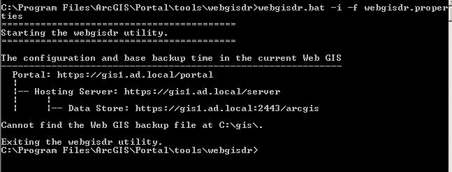

I´m using webgisdr utility to generate Enterprise backup file, but the file don´t generate in folder....look below the process
Result

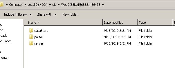

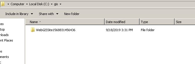

But no files with webgisbackup extension was created.
During the restore the error appear
What I can to do?
Thank´s

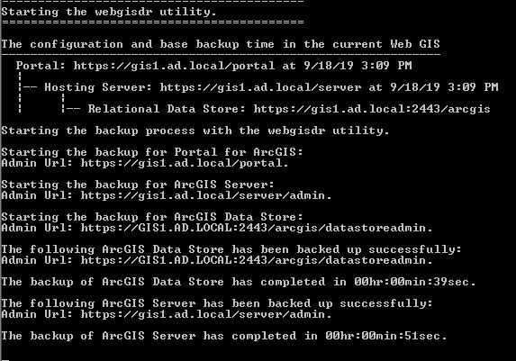

The backup isn't completed yet. You'll see a message indicating that Data Store, Server, and Portal backups completed, then the DR tool will package the backup into a webgissite backup. Let the process continue running. Make sure you don't see "Select" at the top left of the command line window, otherwise the command line stops processing. Press Enter to make sure it continues.

SoratoSouza_e_Silva
Thank´s Jonatahn!! I will try
