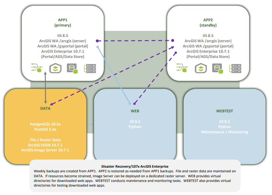

Hello. We are a small, conservation non-profit with a single-machine 1071 enterprse configuration. In addition to the enterprise server, we have a web server and a dedicated data server that participate in the system. This configuration is our second run at an optimized design for our geospatial needs. We do not have an extensive amount of content in our system, we have a few web apps, less than 30 services (map image and hosted feature), and all our data is currently vector-based from FGDBs. Our webgisdr backup file is just a bit over 7GB. See included diagram below.
Diagram displaying dr config
