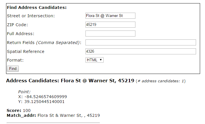

However, I publish a Dual Ranges A.L. (from US Census Tiger Address Features data) and cannot successfully find Address Candidates from the REST endpoint.

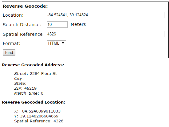

It finds street intersections and lat/longs just fine, and I can even reverse geocode and it gives me the correct address so I know it can interpolate the LFROM-LTO-RFROM-RTO fields, at least somewhat.

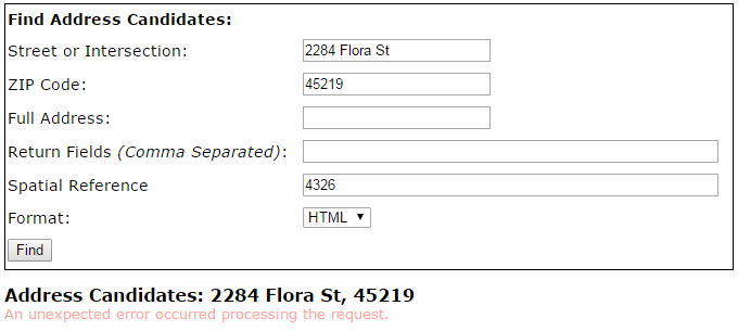

But every single time I enter a house number in the Find Address Candidates option, it fails and gives me an error.

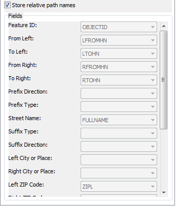

I've attached what I believe are relevant screenshots on how I'm building these.

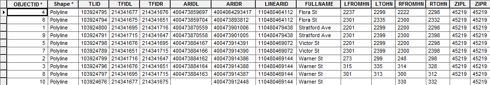

Small sample of data, created/published Dual Ranges A.L. on only this data. Still fails when finding Address Candidates at REST endpoint.

What is the result when you enter the address in the Full Address parameter? 2284 Flora St, 45219
What is the behavior when using the published locator in ArcMap with the Find tool, which is the equivalent to the FindAddressCandidates REST operation?
     -It fails, gives me the same error.
     -It also fails, same error as FindAddressCandidates option.
I've talked to ESRI support and they suggested it was acting this way because I am publishing from ArcGIS Desktop 10.0 SP5 to ArcGIS Server 10.0 SP1. Recommended upgrading server to match desktop version I am publishing from.
Set up date in mid-January to upgrade our server, hope it fixes the issue!

If the upgrade does not resolve the issue, reopen your case with Esri Support Services and they can continue to troubleshoot the issue with you.
