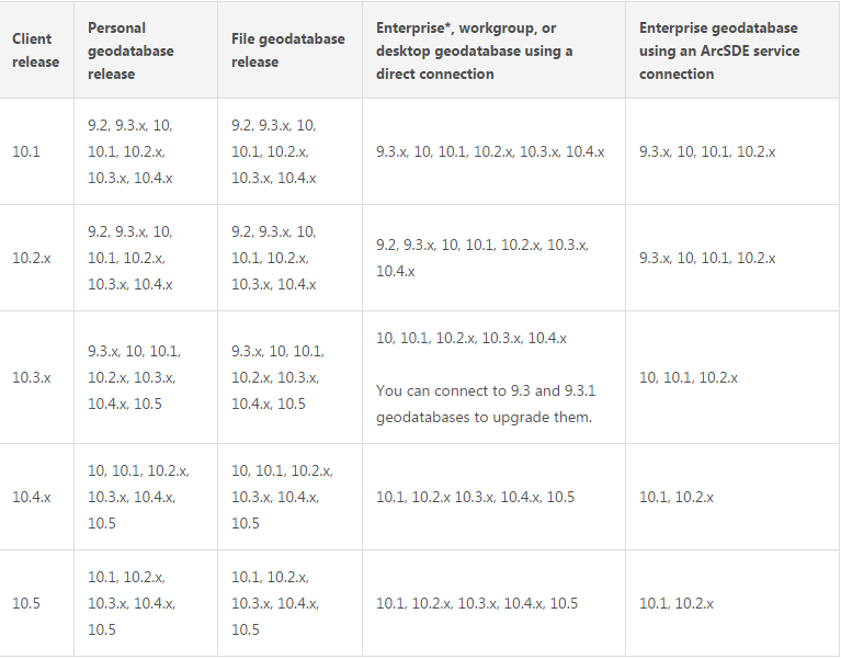

Howdy... We've got a 10.5 server deployment in progress and what I would like to do is a proof of concept migration
from the existing application on 9.3.1 ArcSDE - to 10.5. We have a 10.5 desktop installed, but it looks like there is no functionality available to connect through the ArcSDE service on 9.3.1. The table indicates that we can connect through SDE from 10.2, or via a database connection "for upgrade purposes" from 10.3. Was hoping this would be simpler. So - what is the least onerous workflow to bring the 9.3 data into 10.5? (Scripting would be fine BTW)
10.5 version compatibility chart

I would recommend upgrading the Enterprise Geodatabase‌ to 10.2.2 or 10.3.1, then upgrade to 10.5. You will be required to make an "intermediate" leap in the upgrade process from 9.3.x --> 10.5.
Please be sure to follow the upgrade documentation for each process. Also take a VERIFIED BACKUP of the database before attempting the upgrade process.
I picked SQL Server as an example:
Upgrade to 10.3.1: Upgrade an enterprise geodatabase in SQL Server—Help | ArcGIS Desktop
then Upgrade to 10.5: Upgrade an enterprise geodatabase in SQL Server—Help | ArcGIS Desktop
This should get you up and running.

As long as the version of SQL Server is supported by the version of the enterprise geodatabase. I would also look into what vangelo-esristaff‌ mentioned in just migrating the data via an ArcGIS client into a fresh geodatabase.

If your environment is that ancient, you should at least consider a fresh install and full data migration.  This would allow you to review the data schema and application architecture, and upgrade what is necessary.  It would also permit spatial defragmentation and coordinate reference optimization, which could significantly improve performance. Finally, you would have multiple opportunities to get the data transition correct (a true proof of concept) before migrating the applications.
