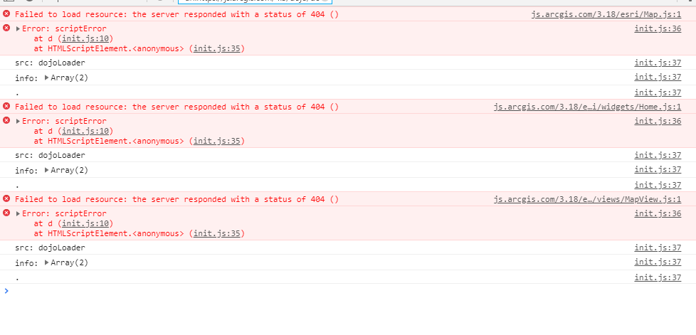

 In the developer console I'm getting the following error indicating that these files cant be loaded.
Our IT department have removed internet access for the ArcGIS Server. So I'm assuming that the Server needs internet access to render the previews  via arcgis.com? Do I need to allow internet access and add a rule allow traffic to ESRI only *arcgis.com?

My ArcGIS server now has internet access however the Javascript Preview is still blank. If I look in the developer console the following urls are returning 404 Not Found Code: NoSuchKey Message: The specified key does not exist.
https://js.arcgis.com/3.18/esri/Map.js
https://js.arcgis.com/3.18/esri/views/MapView.js
https://js.arcgis.com/3.18/esri/widgets/Home.js
I've tried  hitting the URL's from my local machine same 404 errors are returned.
Interestingly if I change the version from say 3.18 to 4.0 I get a response.
Any help would be appreciated.
